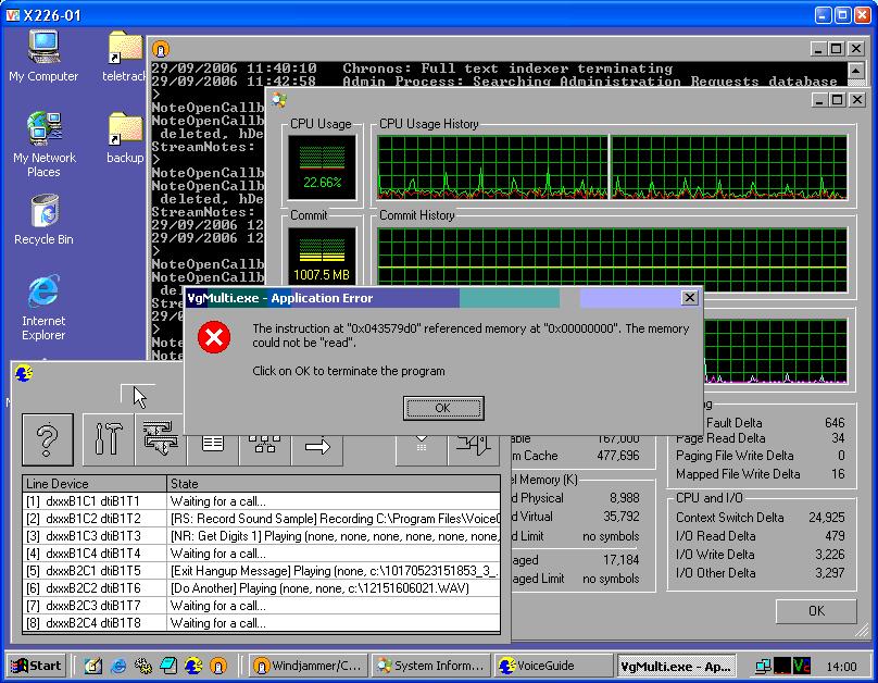

See screenshot of application error attached.

What version of VoiceGuide was running when the screenshot was taken?
The very latest one - 6.0.3164.
